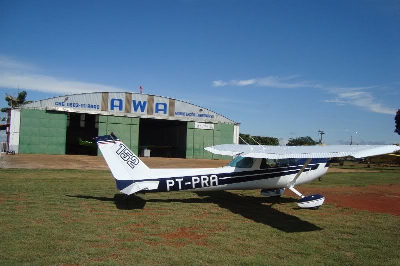

Um amigo meu do mato grosso disse que o patrão dele teria um 'Cessna 152 com trem convencional' duvidei, e ele me mandou a foto agora, consultei o prefixo no RAB e consta como 'Aeronave não Cadastrada'
Afinal, EXISTE cessna 152 convencional, ou é uma EMJAMBRAÇÃO ao maior estilo mato grossense?

Da wikipedia:
Modifications
There are hundreds of modifications available for the Cessna 152. The most frequently installed include:
[edit] Tailwheel landing gear
Taildragger conversions such as the 'Texas Taildragger' conversion are available and have been fitted to some 152s. It involves strengthening the fuselage for the undercarriage being moved further forward, removing the nosewheel and strengthening the tail area for the tailwheel. This greatly improves short field performance and is claimed to give up to a 10 kn (19 km/h) cruise speed increase.[5][6]

aaaaah, resolvido então!
abraço, muito obrigado!
